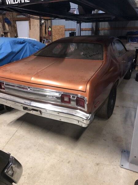

I tried searching a few terms, but I don't even know what these parts are called. On the Dart Sport, some had the rear aluminum/pot metal? Trim around the tail lights and between them. I've attached pictures of mine. The previous owner painted it flat black, and not well. I want to strip the paint, sand away any bubbles and glaring imperfections, and then decide if I'm going to paint, polish, brush, or some combination thereof. How can I remove the paint?
One of my old go-tos is oven cleaner or aircraft stripper, but pretty sure both of those would damage the underlying metal far worse than it is. Other options?
Thanks.
That's a,74 up thing.
Tail lamp bezel and center section
They were when new pot metal chrome plated and then the recessed parts were painted silver.
Best to go d a better used ones.
As the post metal is full of holes now on yours
To replace any post metal or paint is work.
Plating requires full strip and filling holes with layers if copper and sanding. One layer at time
Painting requires the same strip, fill with high build primer sand in steps.
You could shoot it after with a highest silver as you can get.
Then tape it up and shoot the recessed parts a darker silver.
That would be best option.
