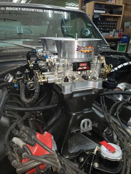

750 Brawler vs 650 AVS 2 at the track, right OOTB !

AVS2 has annular primary boosters to aid atomization. Secondary boosters are regular. If using an Airgap style manifold the annular boosters really aid atmozation for low speed driving and cruise.
