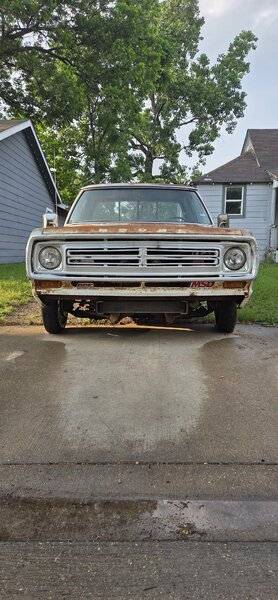

Picked up this center section last week, was wondering how to determine if its in usable shape. It is locked up appears to have been sitting for awhile. The person i got it from didn't even know what it was, part of his late dad's mopar hoard. Have a d100 that has an open diff would like to use it if possible. I appreciate any information from what ive read its a cone type?
