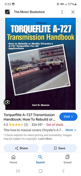

Hey Zack, I rebuilt a few of these in my time. Not that hard. I have a manual ( somewhere) that was step by step. Cover had a FB barracuda pulling the wheels on the cover. Kits are cheap.
