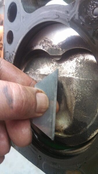

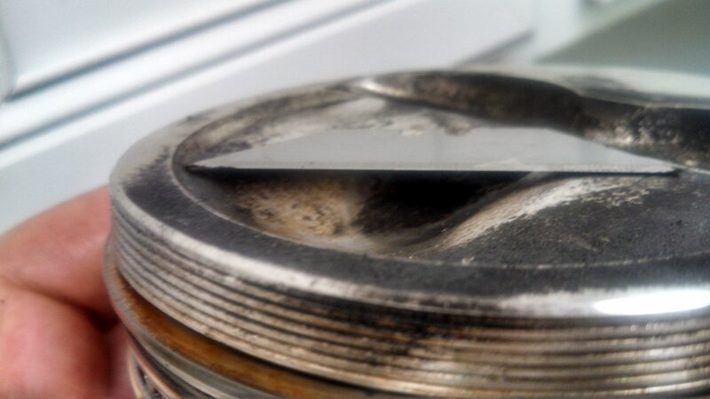

I’m using DSS -18cc forged pistons which put me around 9.2:1 with Speedmaster heads. My research showed that a zero deck height piston at 10:1 is less prone to detonation than an 8.5:1 piston sitting a ways below deck. I have tried the NHRA forged “stock class” pistons and do not recommend with boost. The piston crown caved in. I did also consider the trw pistons but decided against them again due to their below deck height and also weight.

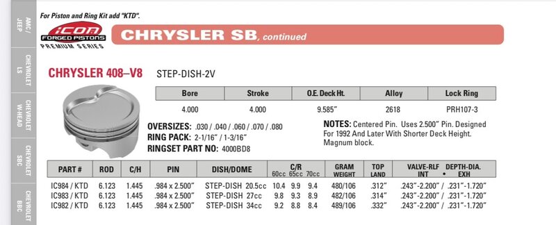

Icon Pistons IC982-030 Fits SB Chrysler Dish 34cc Bore 4.030
Icon Piston IC982 (specifically designed for boost) has a 34cc dish for use with a 360 running a 4” stroke.
I am going to disagree with you that this is a specifically made piston designed for boosted applications.
Nowhere in my ICON book does it state this, and I can tell you first hand that all the blower pistons I've dealt with will not weigh 489 grams.
While the piston you showi does have a 34cc dish this does not make it a blower piston.

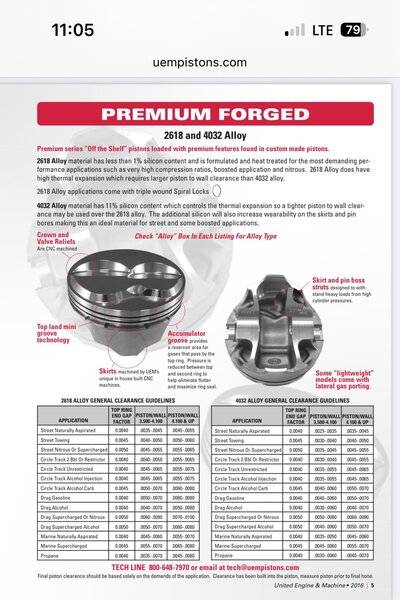

Strange as UEM’s website and tech line states, 2618 alloy is for boost or nitrous applications.
489 grams, so this piston in not actually recommended for boost?
2618 is the stronger alloy of the two used to make pistons, but this still doesn't make an IC932 a boosted application piston.
Blower pistons are far thicker than these are made and blower pistons have really thick wall wrist pins.
Sorry, but these are not blower pistons, but if you doubt me I suggest you call ICON and ask them about using this piston in a boosted application.
