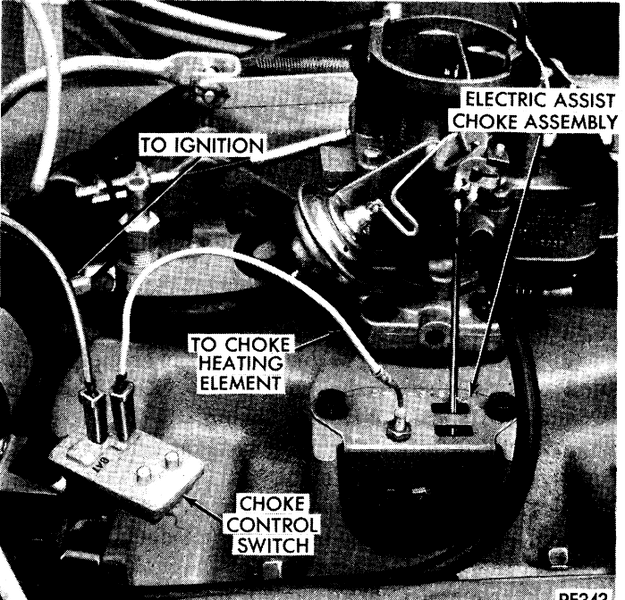

I have found a schematic for the 73 Challenger engine harness that I was told the engine came from. The schematic shows a choke controller component. What does this component look like and how is it mounted?
The Chrysler electric choke control was used on all 1973 - 1984 carbureted vehicles that used the electric assist heated divorced choke. The electric choke control adjusts the rate and time of power applied to the choke thermostat. The control allowed quicker warm-up for sooner choke release above 68 degrees Fahrenheit, and slower warm-up below that temperature. After two to three minutes, the control shuts off the power to the choke thermostat heating element. A single stage and dual stage unit was used. Dual stage units have a finer temperature control and have an external resistor mounted. The style of construction changed in 1977.
The electric control is a small module mounted to the intake or head. The four styles of electric control units are listed in the following and shown in the following image:

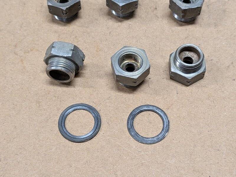

Another, simpler question . . . . the carb's fuel inlet fitting is missing. What does this fitting look like? I am trying to put this project back together as close to original as I can, given that nothing about it is original, if that makes sense! The photo is reference to what I am working with. Thanks again guys!
Jim
The original style fuel fitting is the same for all 1971- 1984 Chrysler applications. Similarly for International Harvester applications, but the Ford applications differ. The standard fitting for Thermo-Quads installs into the body with 5/8-30 pipe thread using a 3/4" hex. The fuel line attaches using a 5/16-20 inverted flare fitting (1/2-20 thread). An aftermarket similar replacement version is available from Walker as part number 90-43. The fittings are originally installed with a rubber coated aluminum shim gasket. Aftermarket replacements may be a fiber washer.
The following image shows the original fitting:
  • Chrysler 3656730, 3698357: 1973-1976 single stage.
  • Chrysler 3755750, 3755770: 1974-1976 dual stage.
  • Chrysler 4049799: 1977-1984 single stage.
  • Chrysler 4049777, 4091034: 1977-1984 dual stage.
The controller is mounted on the intake manifold on small blocks or on the head on big block and slant six engines. The following image shows one mounted:
The controller was not used for the aftermarket Super-Quads with the integral electric choke, but it will work with one. I have been using a 1973 vintage control on my 340 with a Super-Quad for over 20 years.
