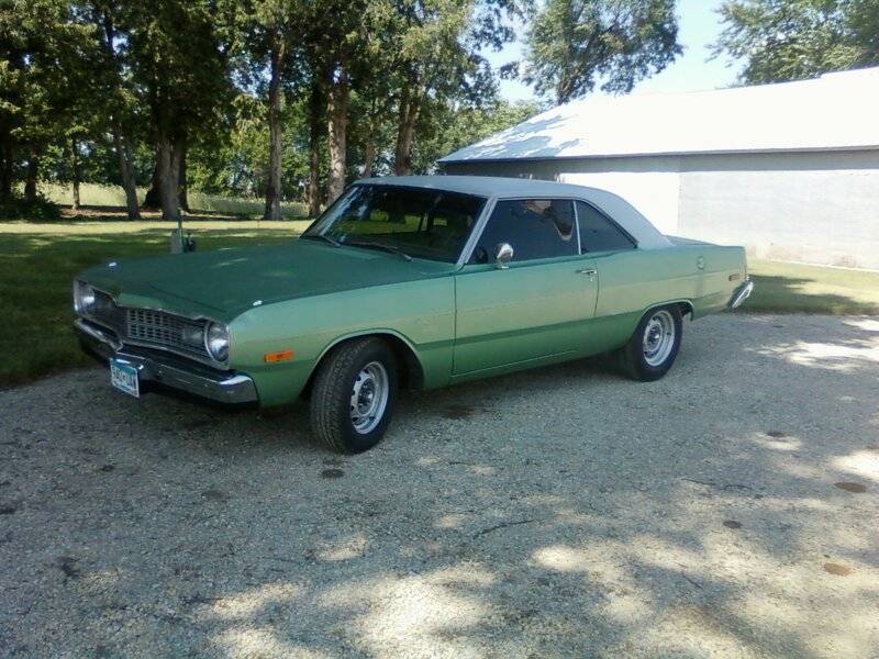

1974 Dart Swinger
Front bumper without bumperettes.
Yes it had bumperets, removed them. Put chrome bumper round head bolts in their place.
Cartridge bolts from the hardware store can work, can polish up the heads with steel wool and wax them so they don't rust.
Excellent. Your car looks good, but that resolution and these old eyes weren't getting along, especially when I didn't know what I was looking for. :) And I did see, maybe at Dante's, Detroit Muscle, or Classic, that we can still order bumper button bolts, so that should work. Greatly appreciated.
