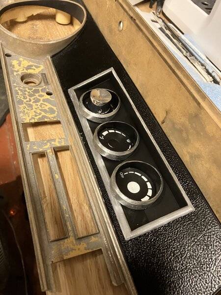

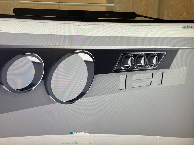

Or dive into the deep end and design your own control panel.
Drawing and prototype shown. Want to do final in aluminum.
