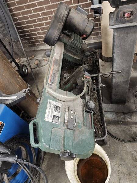

I have one of those Clarke horizontal bandsaws. I bought it about 15 years ago. I cut 3/16 wall 2x6 steel tubing with it. It started cutting crooked then it started breaking blades in just a couple minutes.So I pushed it aside and forgot about it.
So lately I need it again. I put all new bearings in it hoping that would fix it.
It did not. can anyone offer any suggestions?

Some pics can help give more help as well.

Hey Steve that looks to be the same saw as mine only the one i have is black and the brand name is Buffalo sometimes it runs 8 hours a day it has hundreds of hours of use .
