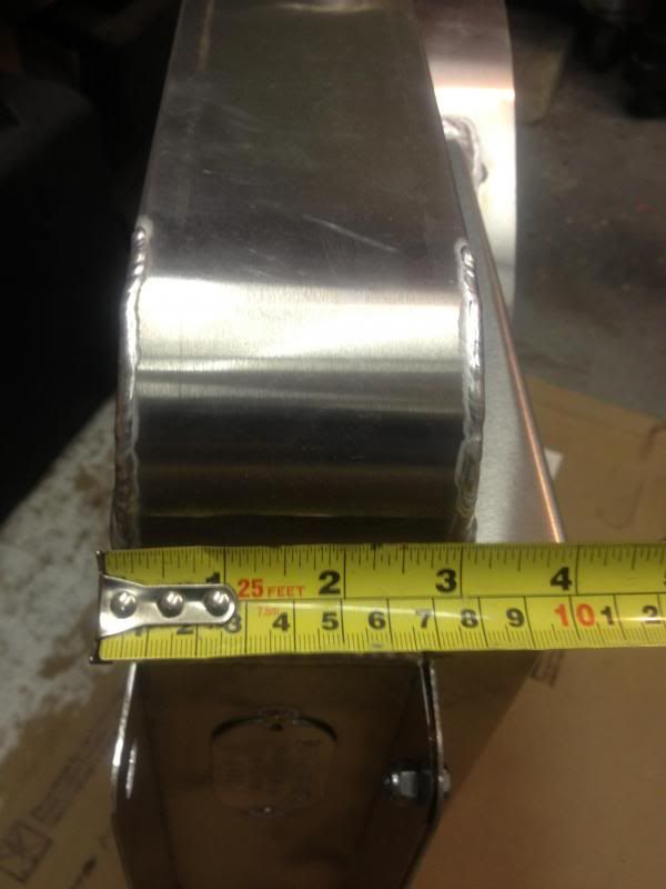

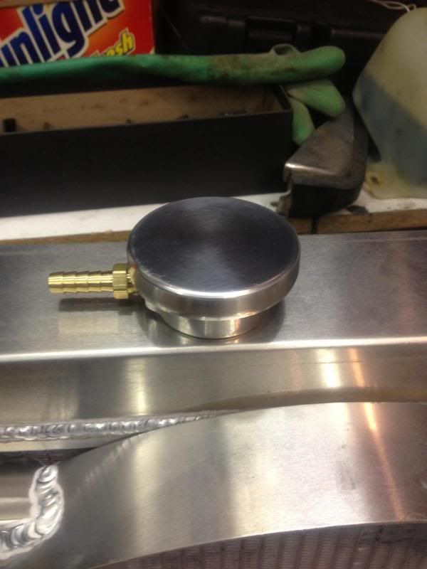

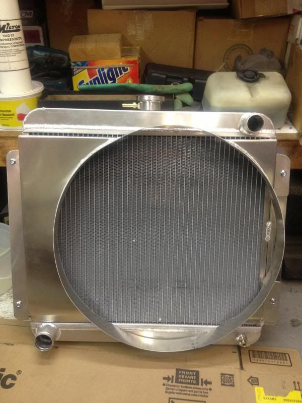

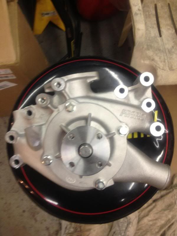

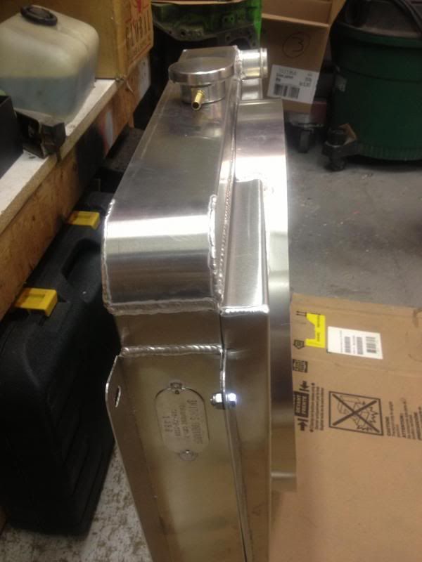

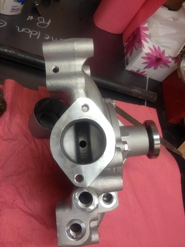

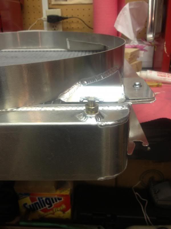

I got my new Big block cooling parts this past week, and i am very impressed with the quality. I got a Smiths radiator, a CVR waterpump housing with a PRW impeller, robert shaw stat and 12 lb cap.
