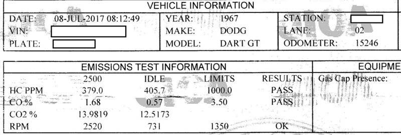

The carb was originally jetted for sea level with the "Standard" jets and after sitting for 4 years and with old gas in the tank I had the car smogged. At that time it passed and all the values were relatively low.
A few weeks later I rebuilt the carb and installed a set of "2 step lean" jets 120-297S, I smogged it this year, still passed, but the values were significantly higher, HC went from 379 to 1358 at 2500 RPM. CO% went from 0.57 to 3.02 at idle.
