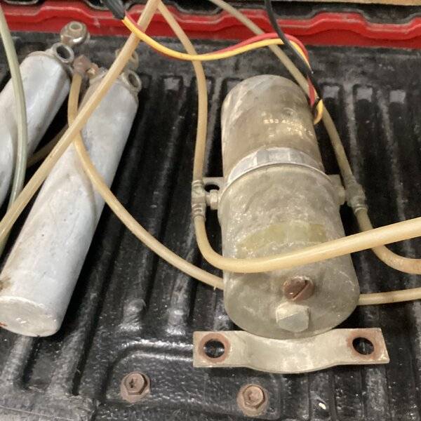

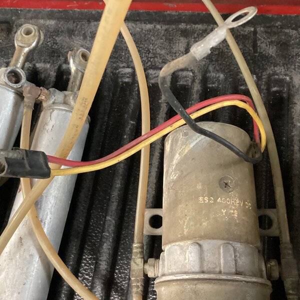

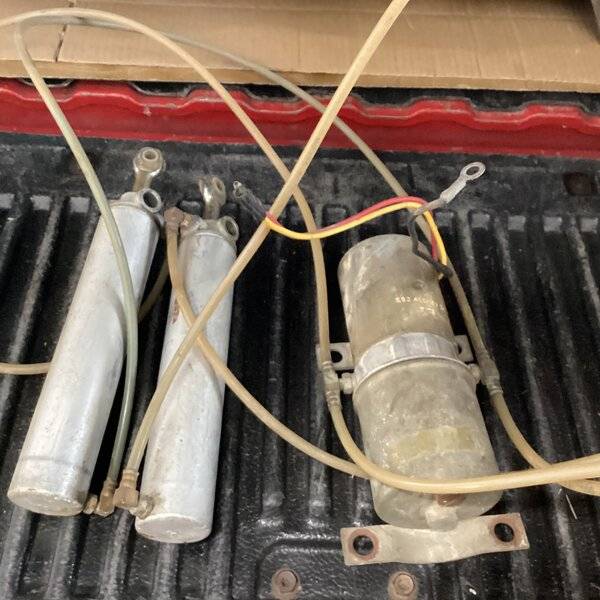

Anybody know what this motor and cylinders is for, I’m pretty sure it’s from a 67-69 Barracuda, going to list it and would like to know what it fits.
Looks like 67-69 a body.
Get me the length of the cylinders I'll let you know if they match mine.
Just the body of the cylinders
67-69 Chrysler used the same pump and cylinders on all bodies.
The 64-65 had a mix of parts the the years and bodies.
Alan
looks like later than 66 , 63-6 had a bottom mount 67 and up had a center pivot , BTW 80's fox body mustangs had the same motors as the 63-66 units but you do ahve to watch the plug ends on the 90s . both mine have 80's-90's salvage yard motors in them.
