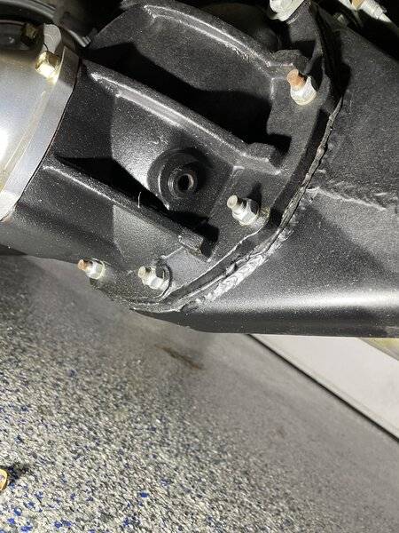

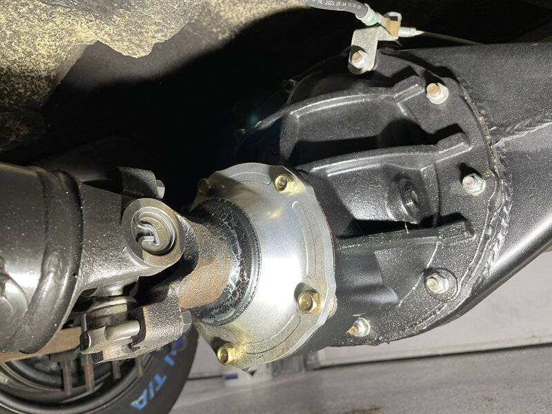

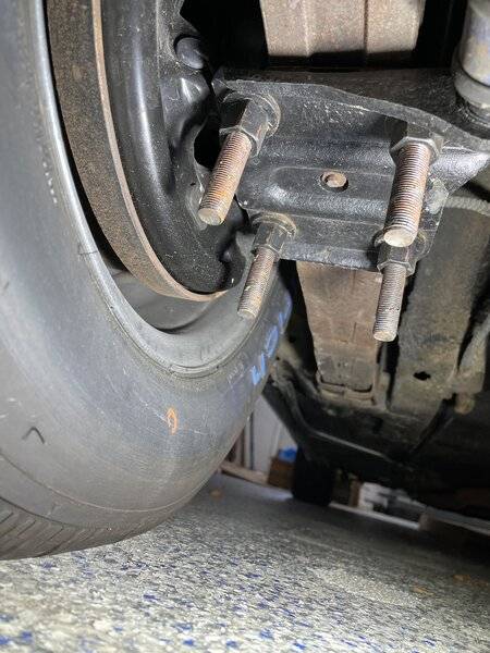

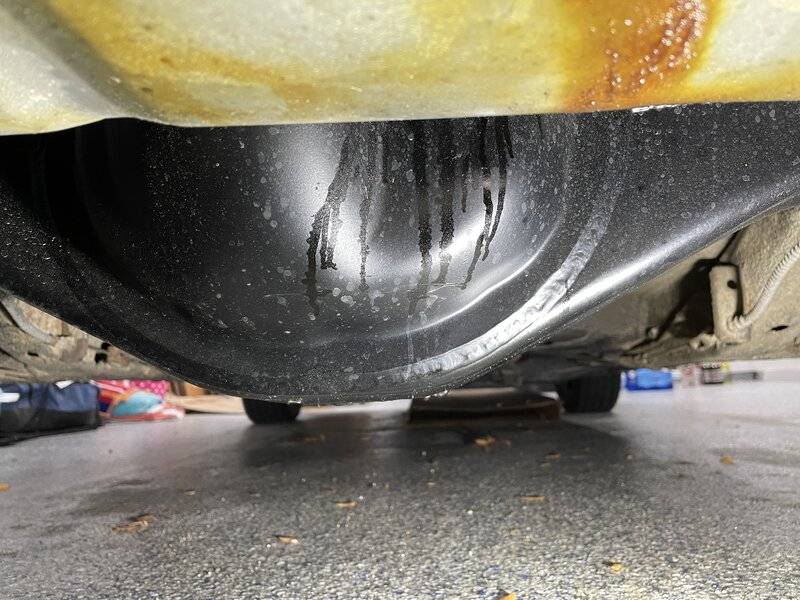

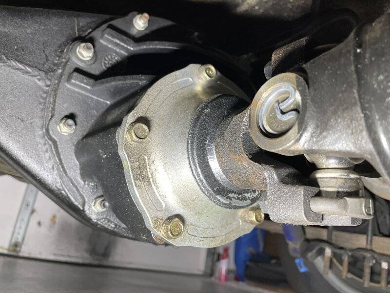

Here’s a few photos showing the leaks. The vent is clear. No fluid leak out when plug is removed. The rear-end arrived complete from Currie but the custom auto shop installed it. Have some automotive knowledge; I’ve swapped out engines in the past. Never had to deal with the rear end which is why I had a new one installed that would accommodate the new wheels. I’ll post a photo of my 66 Cuda next
That doesn't look like it's leakin a river.....so maybe it was overfilled just a little? A lot of folks fill till it drools out of the fill plug, but in most instances that's too full. Most axles have a fill capacity and usually, that's below the bottom of the fill plug.
Currie has done the fab 9” in our race truck for years. They do nice work and your experience with their customer service is exactly the opposite of mine. Looking at your pics, it’s not leaking from “all” the seals because the pinion seal is dry as a bone. The fluid running down the back is indicative of fluid coming out the vent, ie overfilled. The fluid coming out of the backing plates, could be brake fluid but you’d have to disassemble to really know. Just one more point, the amount of silicone squishing out around the pumpkin is suspect to me because I haven’t seen Currie be sloppy in their assembly like that. If that were mine, I’d be driving it down to them to have a look, but they’re only a few miles from me. Good luck.
my thoughts were in the same vein as TT5 & RRR in that it wasn't pouring out all over the place and pooling on the floor.
the betty crocker job on the pumpkin is sus to me; but i've seen (and done) worse.
i'd probably clean everything up really really well and see what time it is. maybe it's a one time event from an initial overfill. or, at least then you'll have a better handle on what's wrong and what direction you need to move in.
but if you had somebody install this, you're kinda SOL on any kind of guarantee in that it's been so long. if you're on good terms with the shop, you might be able to roll back and ask them to take a look with the caveat that they did the work and maybe they do some corrective work and cut you a break on it.
Appreciate all of the information and I’ll clean it all up and make sure the oil level is right. Thanks for the help!!
