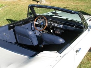

Took some pictures tonight
It is made so I can put the 67 GT emblem back on if I can figure out how to hold it on

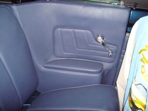

My rear arm rest were shorter and it had an ashtray, made the arm rest longer and eliminated the ash tray.

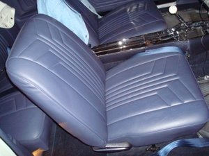

I used the seats out of my 68 Dart parts car
The seats and door panels are covered in Ultra leather
