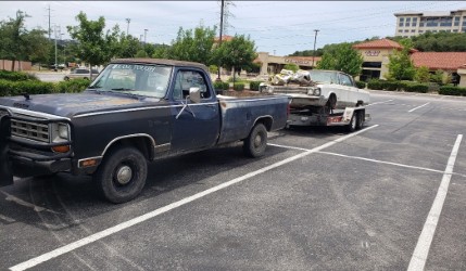

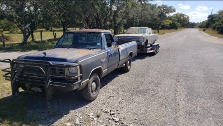

So I have a 84 D100 Slant 6 with the 4-speed OD. If I used an Aluminum car hauler, and put the Duster on there, could the Slanty pull it a couple hundred miles? I believe I have 3:55 gears in the rear. I has an upgraded hitch on it. Opinions?
well, how'd the trip go?
Well.. glad you asked. We've made it to page 5 of how it'll go without it going yet.. it's like watching a YouTube video of how to be a tow truck driver while using your golf cart.. you really won't know till you try it
I was gonna say. You couldda made it there and back five times now. LOL
You don't have Passenger car rated tires, do you. I'd want "D" rated tires, at least, for any towing. "E" rating is much easier to find, but they ride like Rocks! Pass rated tires inadequate & dangerous!
Sounds like might be better off towing the d100 behind the duster
