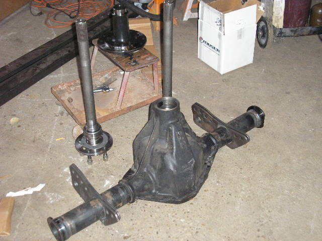

yep you can , you have to have the ends redone with what ever you like 8 3/4 ends or ford ends . here are some pics of my dana 60 that came out of a truck .. you will have to have it shorten to fit your duster . but it will go in i have a dana in a 73 duster..
