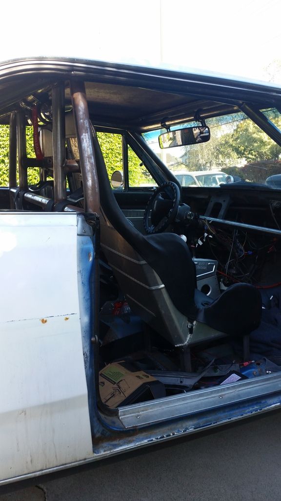

Finally pulled the dash and started working on the front of the cage.
Cutting out old wire and getting ready to make an aluminum dash. That stock dash is heavy....
I'm not crazy happy with the cage but it started life as a generic kit and it's fit is ok.
Now that I have a nice bender and notcher I could have done better but such is life..
Cutting out BS wire.
No way a race car needs all this wiring...
I cut a door bar too short and dont have the stock to remake it. So off to tube specialty in Freemont for a new stick...
Still 16 bars to make but it should be dam safe when done..
I know it's a lot of weight in cage but I dont care. If all the cage makes me slower I'll just add more HP..
