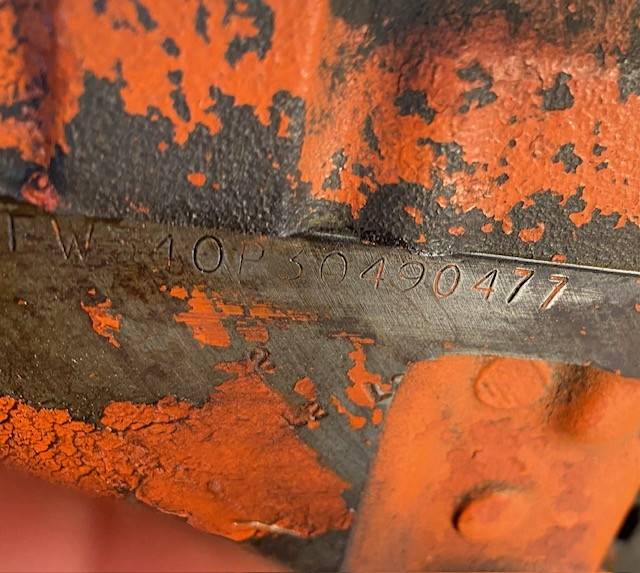

When I purchased my car I was told it was numbers matching and didn't check ..... stupid me. anyway it is a 1970 Swinger. Can some decode the motor for me This is the stamp on the drivers side front of motor FW 340 P 30490477

The number stamped on the driver's side is the engine number. The third post on this thread gives a good explanation 340 engine identification - Moparchat - Home of MOPAR enthusiasts worldwide!. Your VIN number is stamped on the passenger side and starts with 0 (1970) and R (Windsor). The last six digits is the sequence number. Here's a picture of the VIN number on my 340 in my 1970 Swinger.

F = 1970
W = Windsor engine plant
340
P = premium fuel
3049 = Dec 2 1969 build date
0477 = 477th unit produced that day
