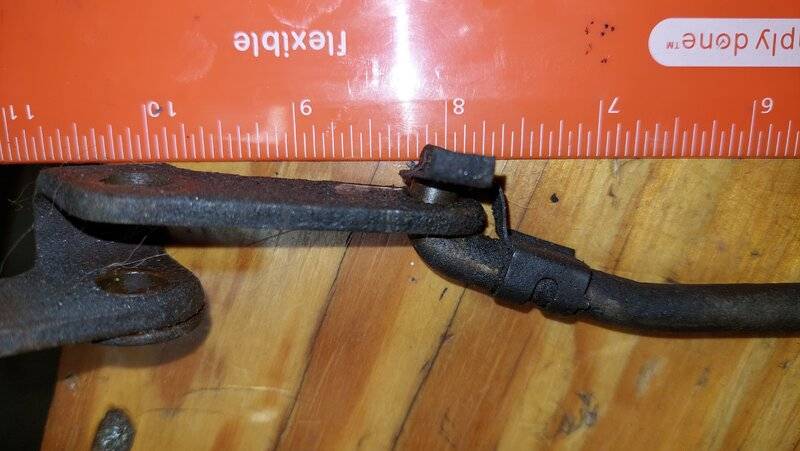

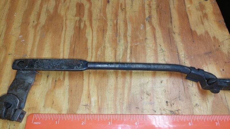

Does anybody know the length of the circled rod? It goes from the throttle valve arm at the transmission to the lower bellcrank pivot. I currently have the wrong lower pivot and rod. I can find the pivot but I can't find the rod. Mine is adjustable, so if I can get the length I can make it work. Any help on this kickdown issue is appreciated. Thanks

Sounds reasonable. Upper is 67 but the lower is just a straight pivot. I found what looks like the correct pivot from classic industries and I will try the 8 inch length that Signet measured
