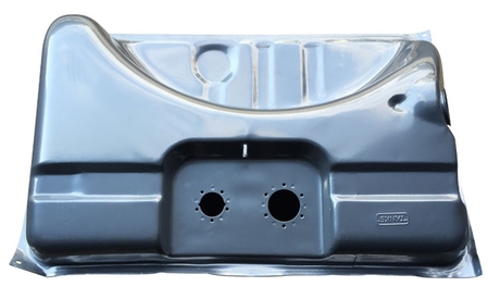

Maybe this for hood clearance
Going in this, which of course is still under construction, interior is only 3/4 done and still needs wheels.
