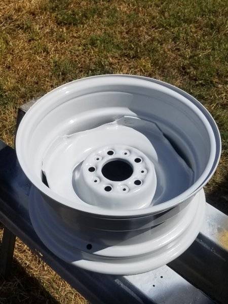

I am using free out of date light grey radome primer from my job. It's a 2 part epoxy that's impact resistant. PPG Aerospace PN# 512x310. This stuff is freaking great. Dries hard as a rock in a few hours. Heres a rim I shot with it on friday afternoon.
I use paper disposable Dixie cups to dip out the primer and activator. I use one cup for each part so I dont contaminate the base or activator. About a half a Dixie cup of each part mixed up in a plastic paint pail is enough to primer one whole rim with none or very little material left over
