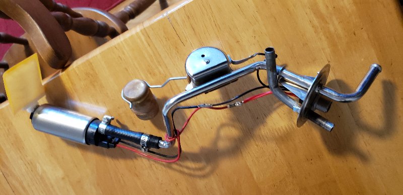

Is the tank baffled? And where does the return fuel go back in to the tank?
Not sure if the tank is baffled.
Return line is Siamesed to the pickup tube .
The whole situation seems odd to me and the only thing I can think of is you’re aerating the fuel for some reason and it’s affecting the pump at the 1/2 tank level. Then you said it happens at 3/4 full also so hell IDK.
Most modern in tank pumps have a bucket that the pump sits in and the return dumps right back in to the bucket. That keeps the air out of the fuel. The pump and pickup for that truck looks like an old school carbureted pick up with a pump on the end. Early adaptation to efi.

That’s my assembly .

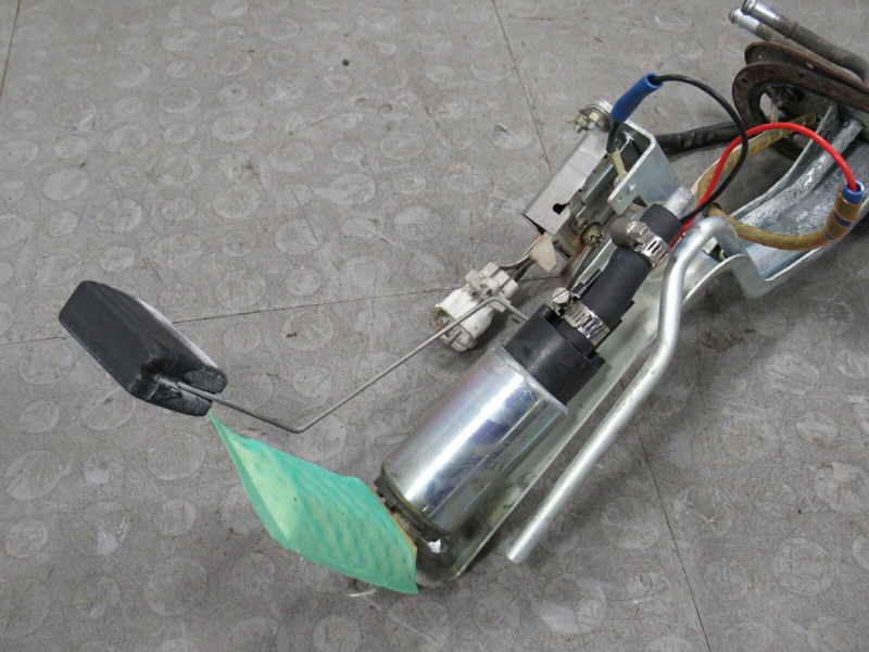

On a related note, most of the so called baffled tanks they sell are not very effective at feeding air free fuel when below 1/3 to 1/4 tank. Using a surge tank system with a stock tank is vastly more effective when driving road course type roads, as any air sucked in from the tank is constantly purged from the surge tank prior to being fed to the engine.
