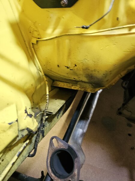

Apr 23, 2025 #1 beck Well-Known Member Joined Nov 17, 2009 Messages 56 Reaction score 37 Hi all, I can use a little help. The frame rails below the iner fender,Are they supposed to be black or color of the engine bay
Apr 23, 2025 #2 Dana67Dart The parts you don't add don't cause you no trouble FABO Gold Member Joined Jul 16, 2017 Messages 19,454 Reaction score 16,825 Location Northern Colorado Entire car is body color.
Apr 23, 2025 #3 340six King Of Bling Joined Jan 4, 2009 Messages 2,294 Reaction score 3,024 Location New Orleans Frame rails got same color as car body. From firewall pinch weld back got whatever flew backwards. So was oversprayed over primer as far as that flew. Except cars that received undercoating
Apr 23, 2025 #4 JDMopar Well-Known Member Joined Jan 19, 2012 Messages 9,113 Reaction score 10,442 Location Candler, NC/Myrtle Beach, SC On a side note....the brake lines, gas lines and any hardware (shock washers, etc.) is NOT supposed to be painted.
