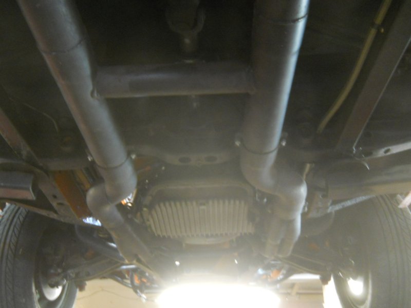

Got Hooker compition headers with 2 1/2" summit exhaust
Right side sounds a little different then left side, car runs great, checked everything right down to the compression. Could it just be the bends in the pipe? Just wondering if anyone else has had this
72 340 Demon
Have a crossover pipe / H-pipe welded in. Make a pipe to fit between the exhaust in front of the mufflers. Cut a hole in each pipe even if its a tad smaller and weld the pipe you fitted over the holes. You'll notice the difference in performance and sound
