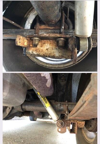

I have a 76 Aspen with a 7/14 rear and the plates that hold the rear to the leaf springs and shock is falling apart on both sides.Does anyone have a set to sell or know if I can adapt ones from a 65 A body to it.I have both 71/4 and 8 3/4 plates for early A bodies but would rather get the right stuff if I can.I need this car for work so i need to act on this quickly.Thanks ,valiantwagon guy (Ed)

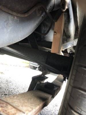

Thanks for all the help with this problem .What I ended up doing is using mid 60's 8 3/4 bottom plates and u bolts.I made 8 1/4 in shims to take up the distance between the bolts and the axle housing to keep it tight. After tightening the bolts down those shims were tight in place and I put a small weld on each one to the pad on the rear to make sure they stay put.I used shocks from an old 66 valiant I had parted out and used a big flat washer to take up that step in the bottom locating bolt to the plate. The only parts I bought were the two washers at a cost of around 5 dollars and it's back in service and working as it should.Here are some photos of what I had,what I now have , and what came out
