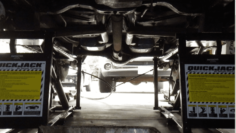

I don't know of any kit other than possible side pipes. I drove mine down to the muffler shop and had them get the tubes angled in and back up under, almost stock location....
I like your photos. Thank you very much. My idea/goal is to have that special look when the hood is popped. All coated Tri-y or two in / two out and back under choices of fender well's depends on tire space for me. It's a street car with mini tubs for small exaggerated street meats for a super stockish look like the BO-29's had. Thinking the back under part could be oval for clearance and somewhat better look. I wish to have the stock look/location tail pipes come out the notched tail pan.
I can tell ya' 165SR-15 on 5" will rub the Hookers on some turns especially turning right into an uphill driveway. Even a D70-14 tire will rub them.
As you can see my tubes running back under the car go under 2" X 3" connectors on a slight upward angle. Not a lot of ground clearance where they bend back under. If you can run underneath headers you'll be better off................................ except for workin' on stuff under there!:)
