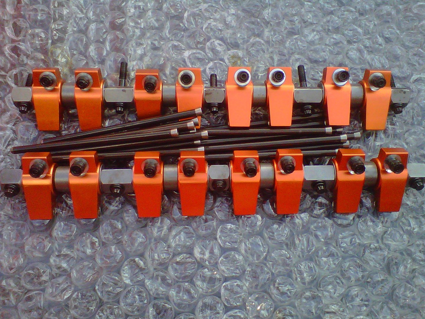

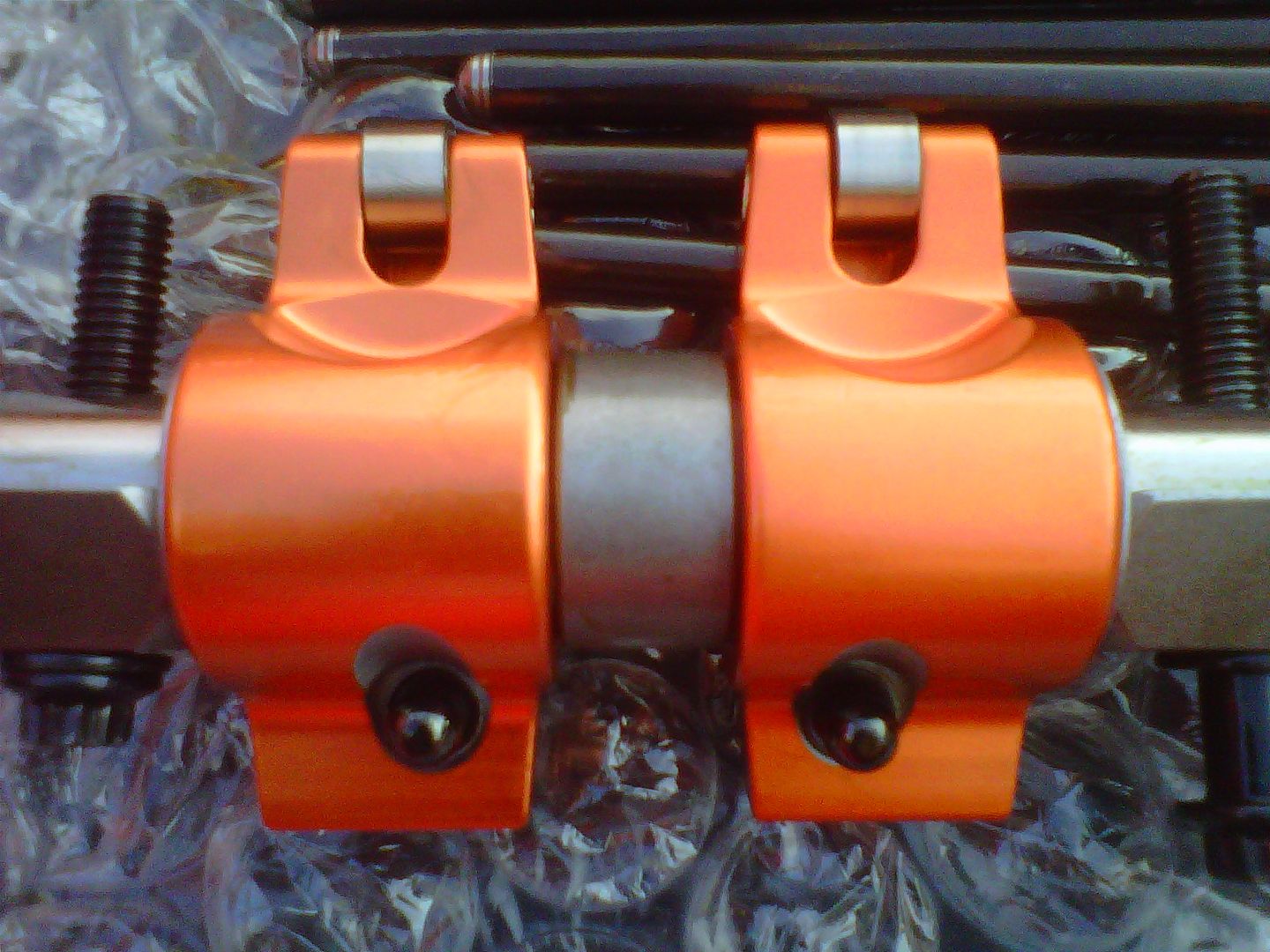

I had them on my previous 440 and now they are going on my new 440 I am building. I went cheap at first then was lucky to find this set brand new on Amazon.com for 600 bucks.
