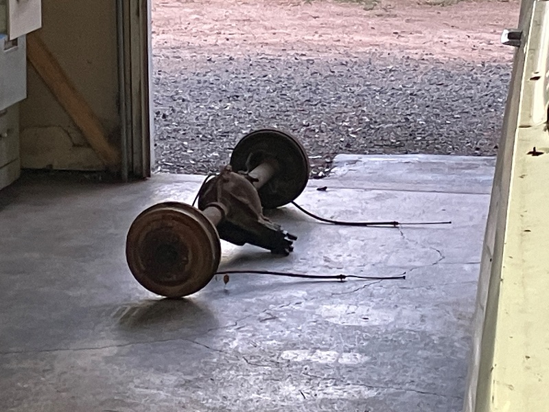

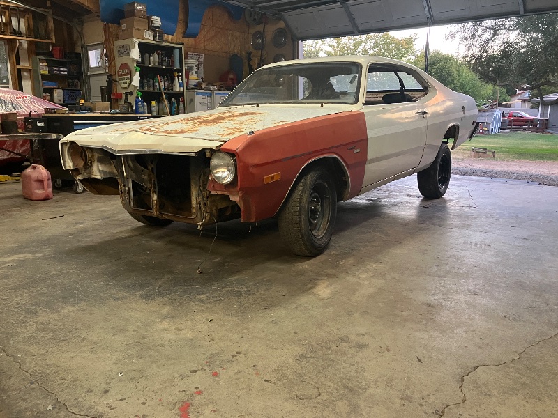

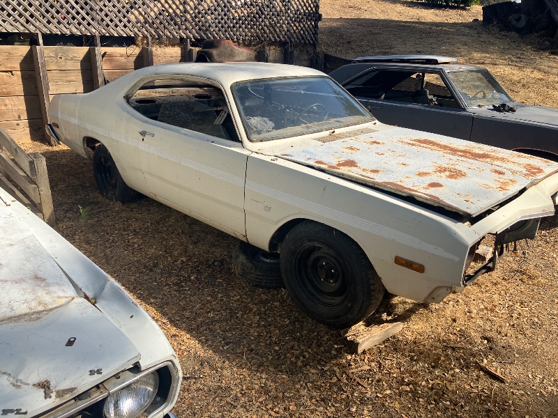

I got a call from a guy that needed a 7 1/4” axle. He blew the spider gears out and needed a direct replacement.
He called the right guy. I have four!

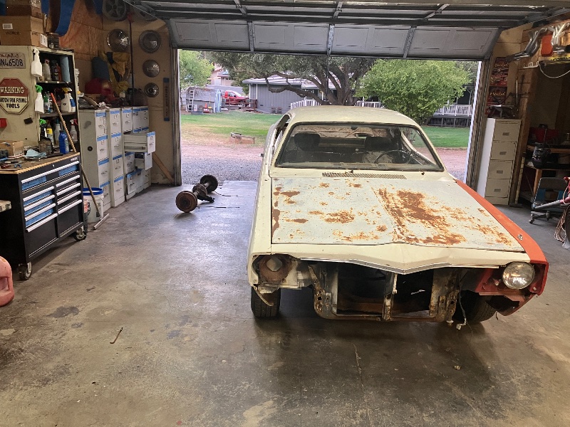

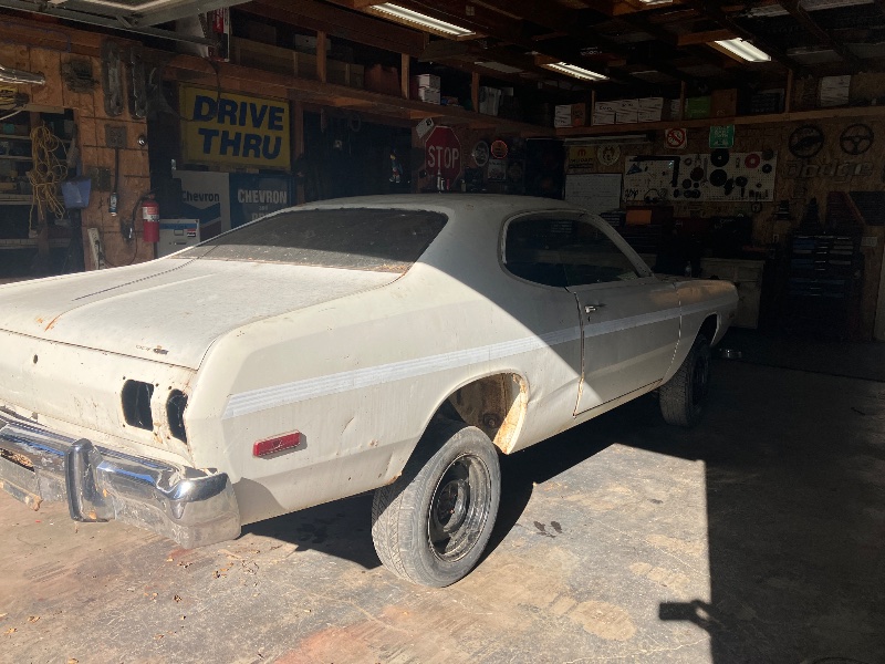

He needed a big bolt unit so that narrows it down to two. This one here in the middle is a Dart Lite, it came with a 4 speed so it had the 2.94 gear. In my experience, 90+% of the 7 1/4” axles had 2.76 gears. I pulled the D/L into the shop….

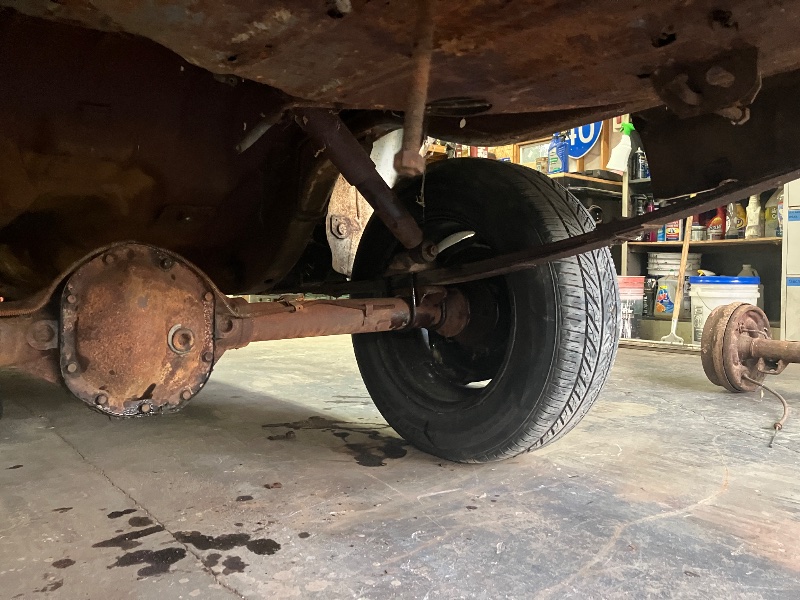

The 2.94 axle is out but to keep this car a roller, I stuffed another axle in it.

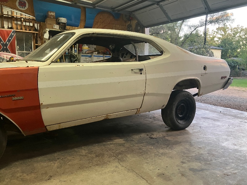

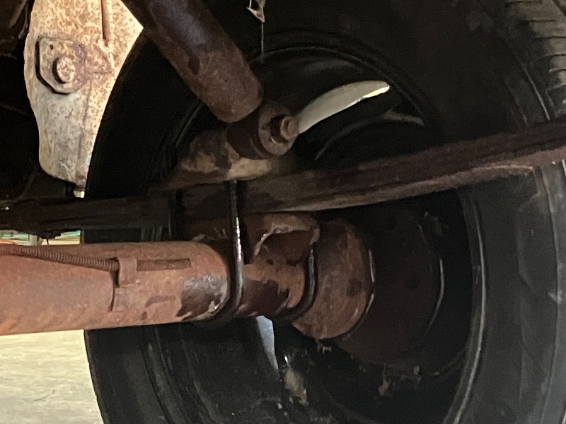

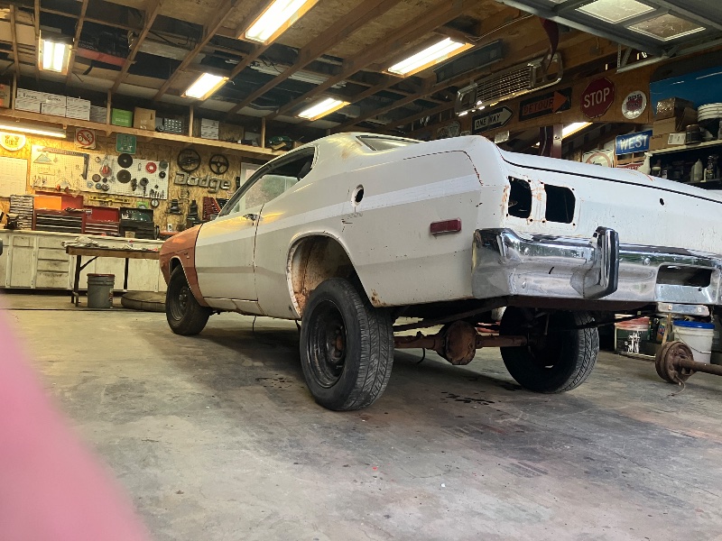

Just for fun….
Yeah…. Axle flip!
The car looks like it is 1979 all over again.
Remember when these cars looked like this??
I have no plans on doing this to any car that I care about. This was just for fun.

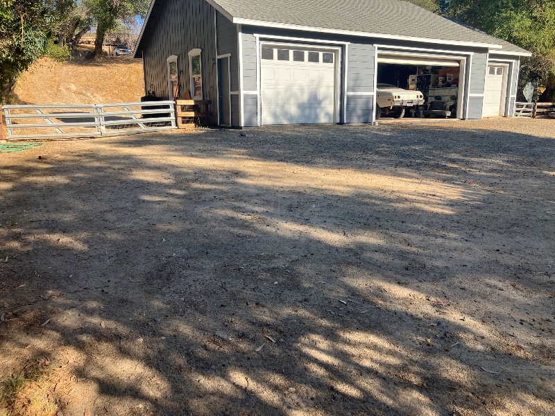

The guy came over and bought the axle that I pulled out. Back to the idle mind!

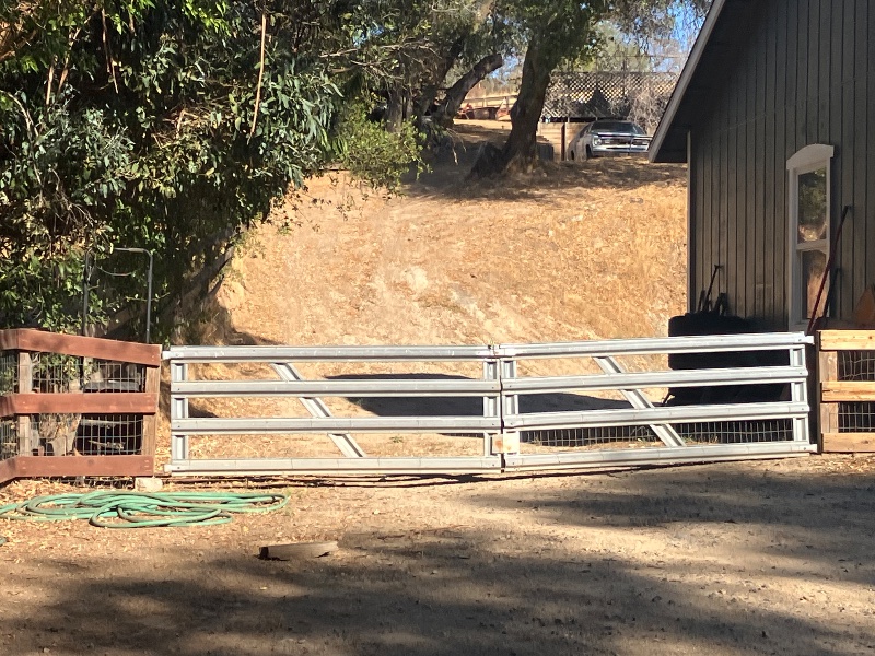

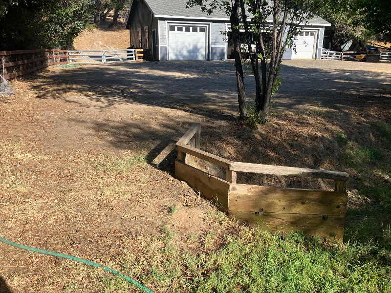

This car will get pushed back up the hill tomorrow or Sunday. Getting it down the hill was a small adventure.
I’ve rolled cars down the hill numerous times without drama. This was not one of those times.

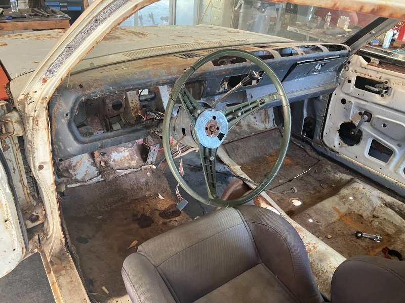

It has no brakes.
The steering column is held up with a ratchet strap that quit tightening, allowing the column to flip all over.
The bench seat I had in it was not bolted down.
The tires did hold air though.
Going down the ramp, it gained speed like usual but the hood flew open, blocking the view. At the bottom of the hill, I have to make a LEFT u- turn to both scrub off speed but to also avoid going into the ditch.
This car rolled so great, turning hard left didn’t slow it down enough. If I kept in the turn, I would have hit the shop.
I went from full lock LEFT to full lock RIGHT to end up in the back yard. I
Used the Power Wagon to push it into the shop.

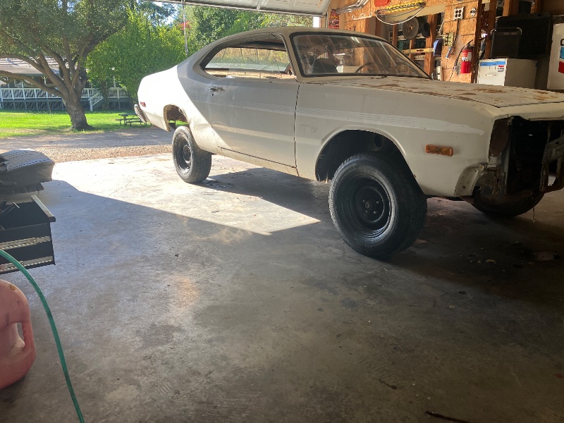

To get back up the hill, I’ll enlist the help of the wife. I’ll push it with the truck. To make it easier, I bolted up the column and put in a better seat.
Just for fun I cranked the torsion bars UP.
The alignment is off a bit…
I clocked the tie rod sleeves to get the toe close to zero. I don’t care about the caster or camber.
