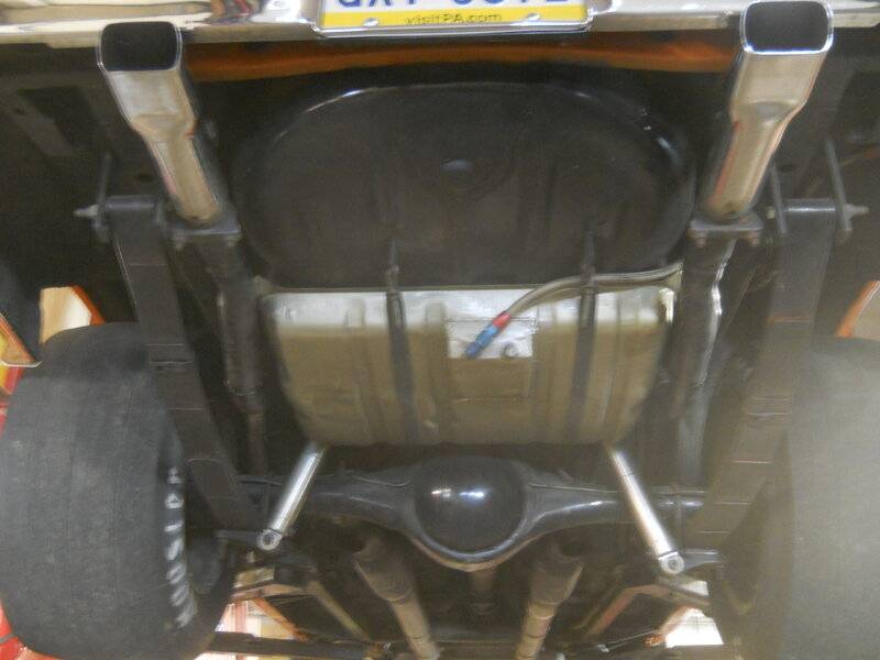

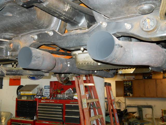

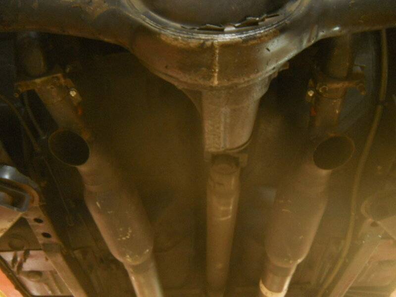

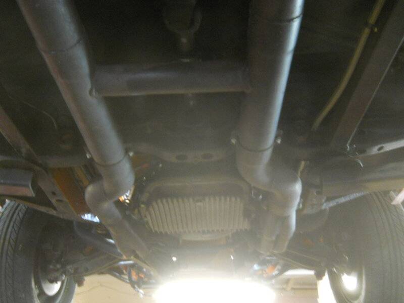

I run 2 inch primaries with 3 1/2 collectors. I gained MPH and more torque through a 3 1/2 H pipe and mufflers. 10.67 @128 through Mufflers 3650 lbs. without driver.

I'm always amazed at you guys that run through mufflers and the performance you get. Just the added weight of the exhaust system alone says you've got some serious Wheaties under the hood. Those are also some great pictures of how you routed things. Very neat and clean as usual - thx for sharing. I know Don (@B3422w5 ) runs exhausts as well and runs very hard. I run a 3" duals on the street but can't really tell about performance as the car is a smoke show with even mildly hammering it.
