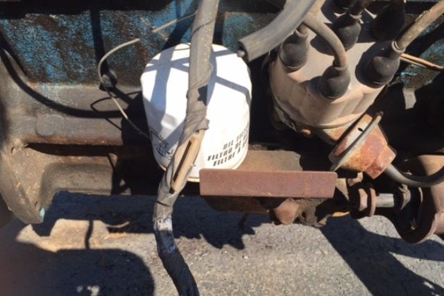

Does anyone know where this part bolts on? Rebuilt the motor and I don't remember. Once I find out though I will never forget now.
That is the 'splash shield' for the distributor. I can't recall what it bolts to but I think it is the oil pump. I have a pic of it somewhere. I'll try to post when I get home.

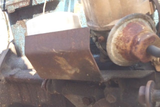

Yes, it's the distributor slash shield and bolts to the upper oil pump bolts
I hope this will be a little more helpful than my last post.
