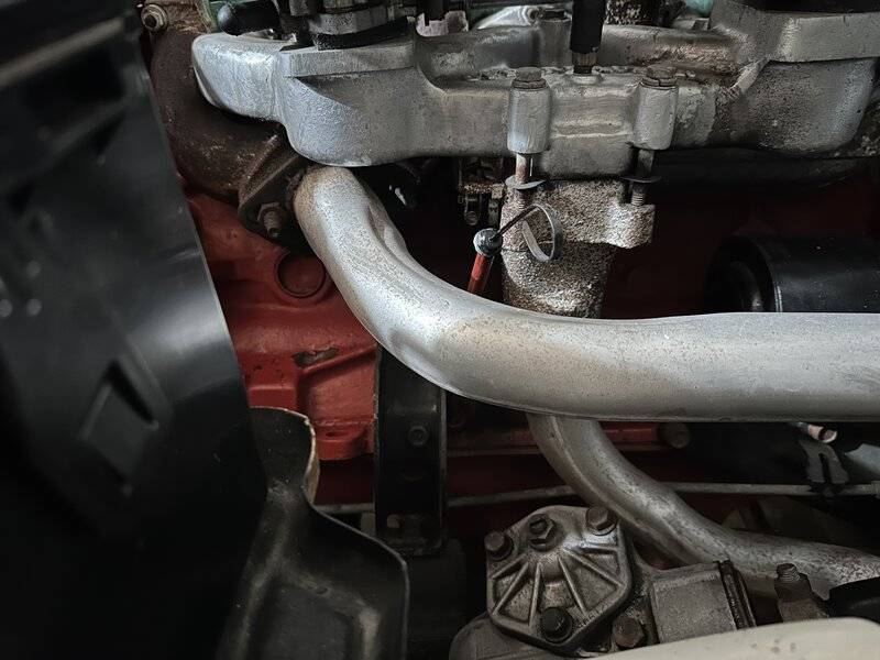

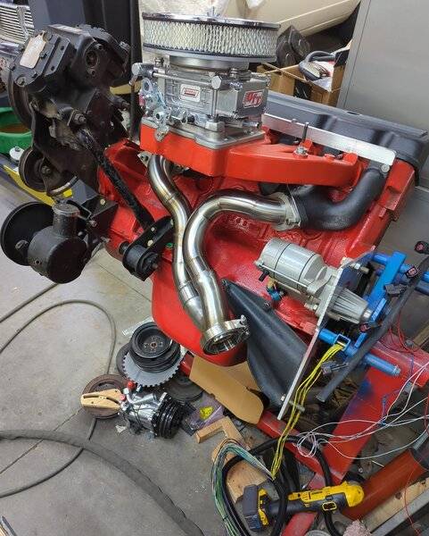

Here are the photos. Clearly these headpipes are larger than 2" but you get the idea. The rear pipe is hard to see, but it drops straight down, then runs to the rear, closest to the block. You can barely see it to the left and below the front pipe in the second photo.

The photos are excellent .
Here's what we did with Vixen for head pipes, although she has the Clifford shorty headers.
