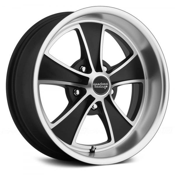

Okay, so I figured out my backspacing and ordered wheels and tires. Fingers crossed I might actually know what I am doing! 17x7 (would like narrower but all they had) in front, 17x9.5 (wanted a 10 but close enough!) in the rear. 225/50/17 front Nitto Extreme 555, 275/50/17 rear Nitto Extreme 555. Rears are just a tick under 28 inches tall which is exactly what I wanted. Discount Tire has the screaming deal on Ebay right now and I saved $100 on the wheels and $100 on the tires (2 separate orders to do this). $840 for everything shipped.
+8 = .315", but that's just the offset from the centerline. A 17x9" with a +8 offset has 5.6" of backspace. I use this calculator, you input the offset and it will show you the backspacing. Rounds it to the tenth though. Also a good way to compare your new combination vs. your old combination to see if it will clear, because it tells you the difference in the locations. Custom rims, rim tire packages for your ride - RIMSnTIRES.com
