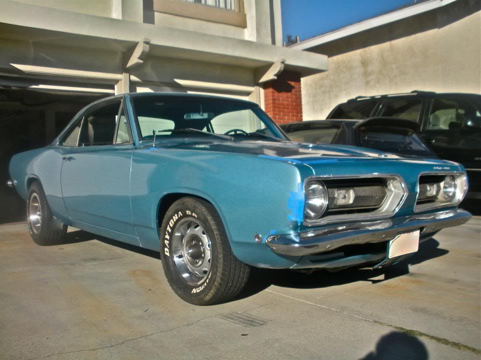

heres a photo of my Barracuda. been working on it non stop.
this is how it looks right now .
got the wheels from jegs. they sent me two defective ones i had to send them back two times because i didn't know the 2nd one was bad. it was a HASSEL !
REAR wheels are 15x8 4.5 - 4.5 backspacing
REAR tires are 245/60/15 i could of fit 255's easy
FRONT wheels are 14's fronts are stock came with car. I'm not sure of the backspacing -
FRONT tires are 235/60/14 I'm thinking of getting 215/60/14's or 225's
