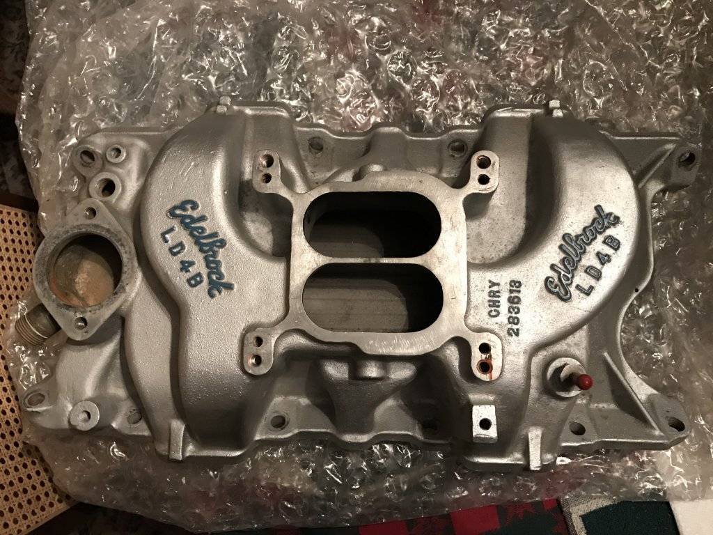

How to remove a rusted/frozen radiator hose barb

Port-holio, thanks for posting. I have to do this on mine and I was trying to figure out the best way. Now I know. I love FABO member's knowledge!
Mine looked even worse. I used rust penetrator had heated it with a propane torch for about 5 minutes, let it cool down. It came right off with vice grips. Yes, replaced with brass!
