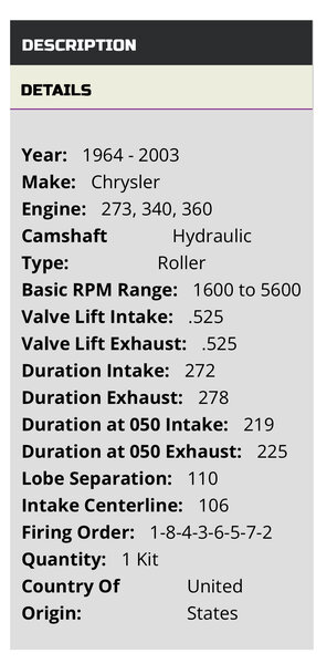

I recently asked Howards and Hughes about a roller cam recommendation.
I still haven’t heard anything from Hughes but Howards was quite quick with their answer (cam specs attached).
I am interested in any advice I can get according to those two companies.
Everybody wants to sell their stuff but IS IT WORTH IT?
318 with J Heads (1.88/1.60)
Zero deck KBs with I-Beam rods
RPM Airgap with AVS2 650cfm
Big port manifolds
Lunati Voodoo 10200702 cam
Torque is the goal.
It won’t see 4000rpm most of the time.
Thanks!

At that RPM range and the compression ratio that you are most likely at there's no advantage to any camshaft with much more than factory duration. If that second camshaft spec sheet is the Howard cam it looks good pretty fast rate and would need good springs.
If the Lunati cam in your Duster is good, it should work fine as long as you match the lifters back the way they are now. If you use the other cam, you will need better springs, Morel hydraulic roller lifters, custom push rods and adjustable rockers. If the Lunati is good to go, it will save you a wad of money!

You have the Lunati in your engine now, and it's in good shape? Leave it! The roller will give you almost nothing noticeable, and empty your wallet a huge amount.
Imo, the value of a roller over a flat tappet starts showing up when you get into 250-270 degrees at .050, and 6500 rpm, 4.10 gears, and 4000 stall. For your application, it is absolutely NOT worth it!

The j heads, in all likelihood, are going to be a great leap backwards from your present “cheap aluminum” heads. Giving up the cross section area and valve opening area is counterintuitive to torque production everywhere, not just at peak rpm. Unless they’ve been milled to the same chamber volume as your present heads, then, you’ll also have a loss of cylinder pressure, which will be a worse for torque.
It sounds like you’re really close to what you’re wanting, just use your present combination with Oregon 1458 cam. Have the LSA set on 108 and the intake centerline ground at 104.
206/212@.050, 258/264@.006, 480/488 lift. Your present springs will work fine. It’s mild enough that it could be ground onto a stock 360 LA hydraulic roller core if you had access to one.
