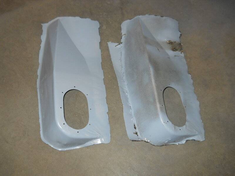

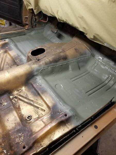

There are two different sets if your car has a 4 or 3 speed hump like in these pictures below. The front carpet will be molded for this hump added to the floor.
