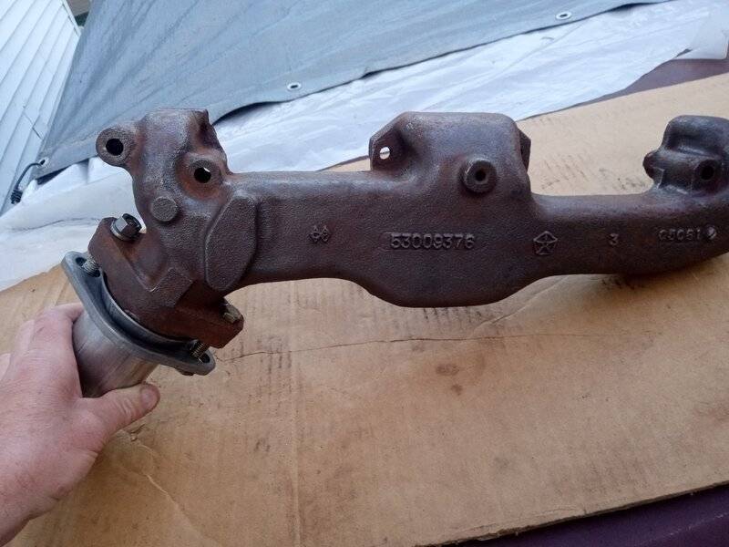

I searched the site looking for the answer as I know I read it a long time ago but couldn't find. I am wanting to run manifolds instead of headers for a modified 318 (less than 400hp) for a mostly street car. I didn't want to lose low end power or deal with any header issues. My friend grabbed a pair of Jeep manifolds, part numbers: 53008378 and 53009377. I wanted to confirm that those are the manifolds that have the larger diameter (like the Dakota RT) than the ones on the trucks and cars. Thanks
53009376 is passengers side large outlet
find a drivers side 340 those are large outlet not just the 68 to 70

I have a drivers side '93 Manifold that I couldn't use because I have PS. I went with the 340HP on the drivers side and the '93 Magnum on the passenger. and yes the openings on the Magnums are 2 1/8" and the 340's are 2 1/4". I opened the Passenger side up a bit to come close to matching the 340.
