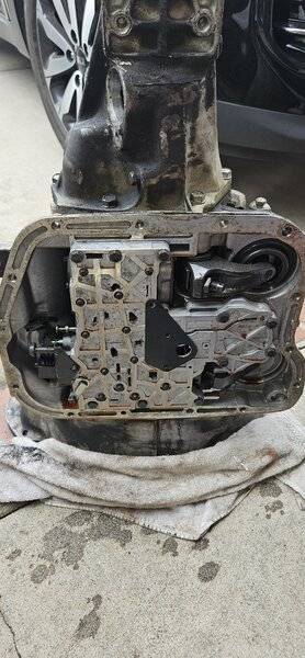

Just got myself a 727 for my 65 Dart project. Code on the pan rail is PK4058332 6191 4455. The owner said it had sat for about 30 years, and mentioned it may have some upgrades since he used to work with TransGo on some prototyping and early product testing. Got 2 torque converters with it too, he said a stock stall, and a low stall that was used for 4x4.
He said it'd be a good idea to go through it and just check all of the seals. I've never dug into a transmission, but I'd like to learn so I'm looking for any advice and things to look for. I've seen the pinned videos for the 727 takedown and rebuild, and I'm looking into getting the book that seems well recommended on here. Just not sure if I need those yet if I'm just going to be checking seals and stuff.
I intend to take a Gearvendors unit and put it on the back to get overdrive. I've already got the unit, just have to take it off my AMC 727 and put it on this one.
Are there any tests I can do with the transmission outside of the vehicle as it is now? Anything visual I can see that may give me an idea of what I may need?
