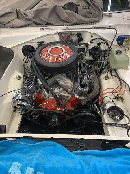

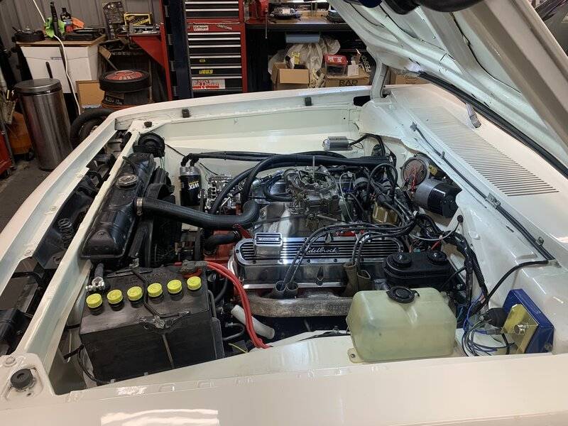

this will allow you to use the Saginaw pump on your cast iron water pump. Depending on the return outlet on the pump that line may be close to the exhaus, I put a heat sleeve on mine.
Had not seen that one before- good to know. I wonder why it's listed as a "reproduction" bracket? I always thought Sags never came on early iron water pumps. Learn something new every day, I guess.
