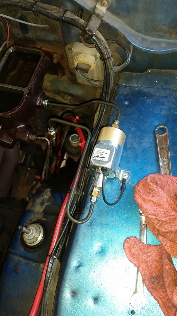

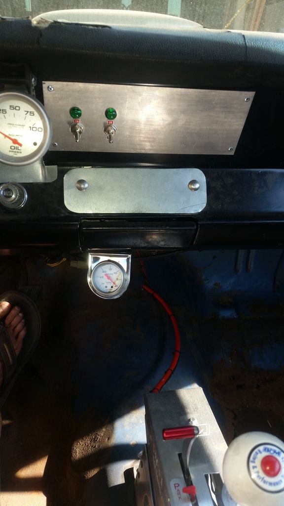

Finally got my line lock and 2 step working.
I could not get the line down to the distribution block off with out pulling lots of **** out so I went for a union..
It all works as it should but it don't seem to help my car leave the line. I just seem to spin the tires now.
I have it set so I can run one or the other or both, maybe I just need to play with the low rpm?
A line lock and two step isn't going to help traction. I fact having the pedal on the floor when the two step goes off just makes it worse. Now you need to be working on traction and getting the car to hook up.
Car should not move with a brake applied. If it does you need to adjust bands or replace clutches. It will only get worse.
