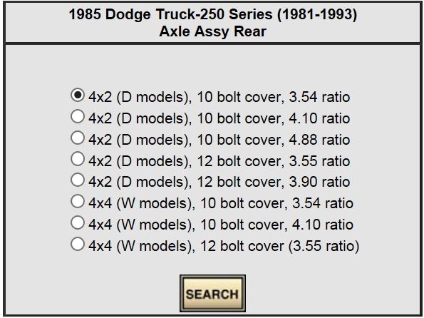

I have recently purchased my D250 with a 318, and 3 speed auto. Im looking for a posi rear end that will fit this transmission and if one is not available, what trans and rear anyone would recommend. Thank you
cant possibly answer this without knowing what rear axle you have now. if you are looking for a "POSI" maybe a 10 bolt out of a Camaro would work
1st determine what rearend you have,prob a 9 1/4,then find a sure grip or limited slip for it's application,using the term posi[chevyterm] will get you some ribbing...it's possible you could have a dana rear,how many lugs does your wheels have?if 8 lug then you have a dana or a spicer type rear,if 5 lug then prob a 9 1/4..after rereading your post and the trk is a 250 you most likely have 8 lugs which rules out the 9 1/4...look up the trk by yr and model to see what you have or chk under hood for description of options[if its still readable] or better yet post a pic of the rear end cover plate
