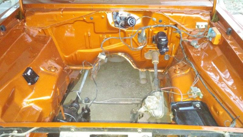

Here is a picture of the box in my duster
Your best bet would be to order the correct pitman arm for your car and measure the inside diameter. Then buy the correct box you need to fit it.
