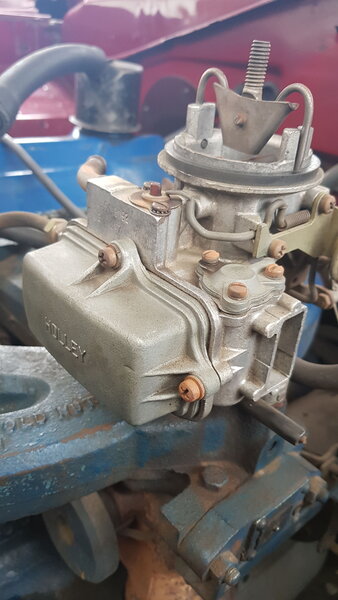

First thing that happened after i signed the papers was the Holley 1920 flooding and needing a complete rebuild.

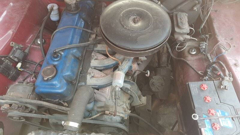

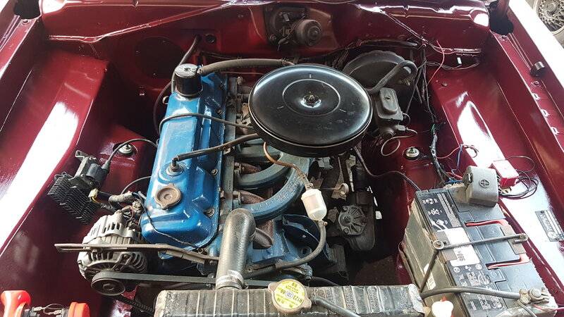

Engine bay looked rough but nothing a deep cleaning would fix.

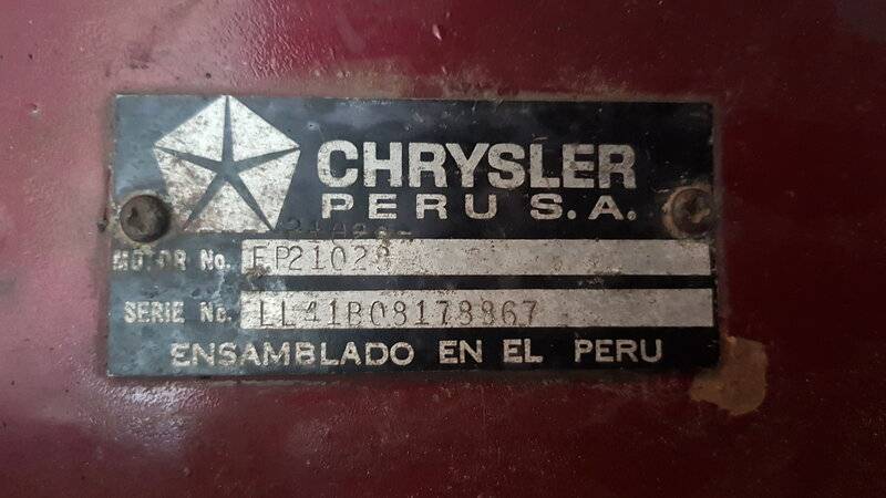

After that, i wanted to check the VIN and the engine code.
i got help from SlantSixDan here but it still had a lot of interesting things.
They put in the VIN that the car's engine is a 198, but it is indeed a 225. From what i asked when i was in Peru to an old factory worker, they would just put anything that was available at the moment.
FW225R L 3066 0643 is the engine code, which Dan also helped withL: Dart
L: Low trim/price class
41: 4-door sedan
B: 198 cubic inch engine
0: 1970 model year
8: Vehicle build factory identifier—"8" is not within the North American factory network; given the body plate it would seem to indicate a Peruvian build plant.
178867: Vehicle serial number
F: 1970 model year
W: Engine built at Windsor, Ontario Canada
225: Engine displacement
R: Passenger car engine
L: Low compression ratio (for export to countries where the available gasoline had lower octane than was available in North America)
3066: Engine built on 19 December 1969
0643: Not relevant outside of factory
