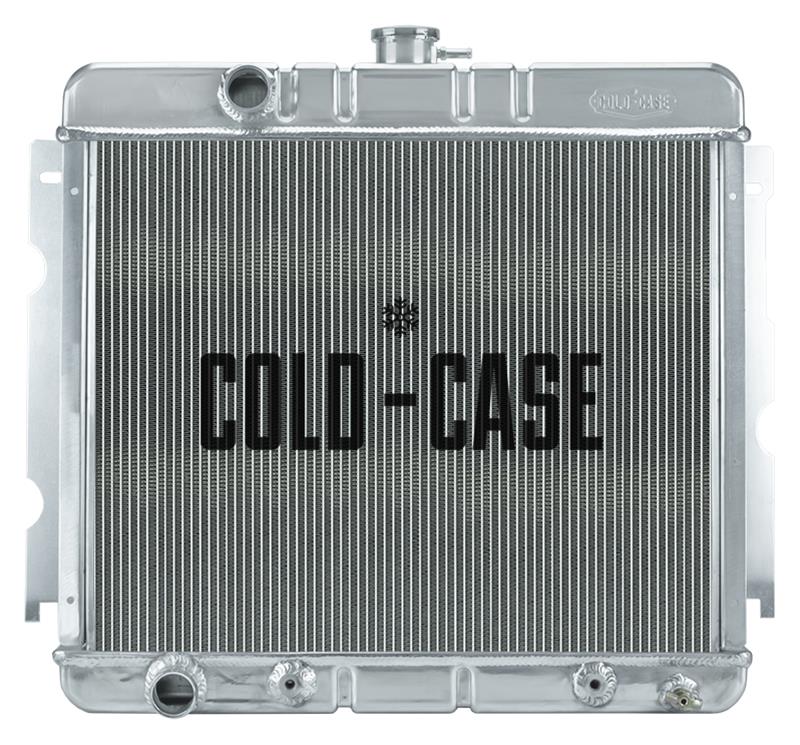

The issue with aluminum radiators is they don't have any shroud mounting and if they do they space the shroud way from the radiator, so you have to fill those gaps to get the most out of the shroud. Second is they are thickener than the stock copper radiator, so fan spacing could change.
I have a Cold Case in my car (I have a 70-up water pump, cover and damper) and it came with all the issues above but is a good cooling unit but they cost a bit more than Champion.

I have a cold case radiator and it has worked well in Las Vegas, Nevada desert heat and has worked well in SW Missouri Humid Heat.

I have a Cold Case in my '69, with a clutch style fan, but, you have to use the cast iron water pump. So choose the correct radiator. No problem with mounting a shroud. No cooling issues either.
which cold case are you running and with what shroud?
