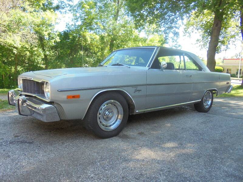

I know it's a different year/body style, but these are the 205-65 15s on my Swinger.
No interference on the 15" C body 16 slot Road Wheels.

Like I said, there's no interference. I initially had the t-bars set a little low, and I had very slight rubbing if I had the wheels turned to full lock and hit a bump a little too fast; like pulling into a parking lot too quickly. Returning it closer to stock ride height eliminated that.
There's lots of clearance to the rear leaves (and to the fender lip), can't give you a precise measurement since it's put away for the winter, but suffice to say it isn't close.
Keep in mind though, that this is on a '75 which has a little more distance between the spring and wheel mounting surface due to the larger axle flange offset and wider drums that were used in '75 with the big bolt pattern, as compared to your small bolt pattern early 'Cuda- probably amounts to less than 3/4" per side or thereabouts.

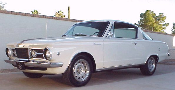

My (4) 15" x 7", 5 on 4 Ralleye wheels arrived yesterday from Summit. I hope I didn't make a mistake going with 15 X 7, couldn't find any 15 x 6 available. I've spent a good deal of time researching tire sizes to use with these wheels on my '65 FS. I mounted up one wheel on the rear axle, and there is 1-1/2" from the wheel edge to the rear leaf. The K frame is not installed so I can't test the fit in front, and without tires just fitting the wheel doesn't tell you much. The tire size I'm most likely to buy is the 225/60R15, like what Clifcuda65 shows on his car. I sent a message to Clif, but haven't heard back. He hasn't posted in a long while, hope he's OK, I've been following him for a long time. Here is his car with 225/60R15 tires. If I have to drop a size to fit, I'm concerned the wheel width will be too wide.
