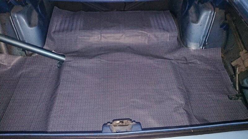

Hi all,
For a long time now, I hear a loud noise in the trunk while driving, especially on bumpy roads. Like if an heavy thing was bouncing into the trunk.
It is very unpleasant
Despite my searches, I didn't find where this noise comes from.
It's not the spare tire, jack or tools, not the exhaust, not the gas tank, not the rear seat, not the package tray...

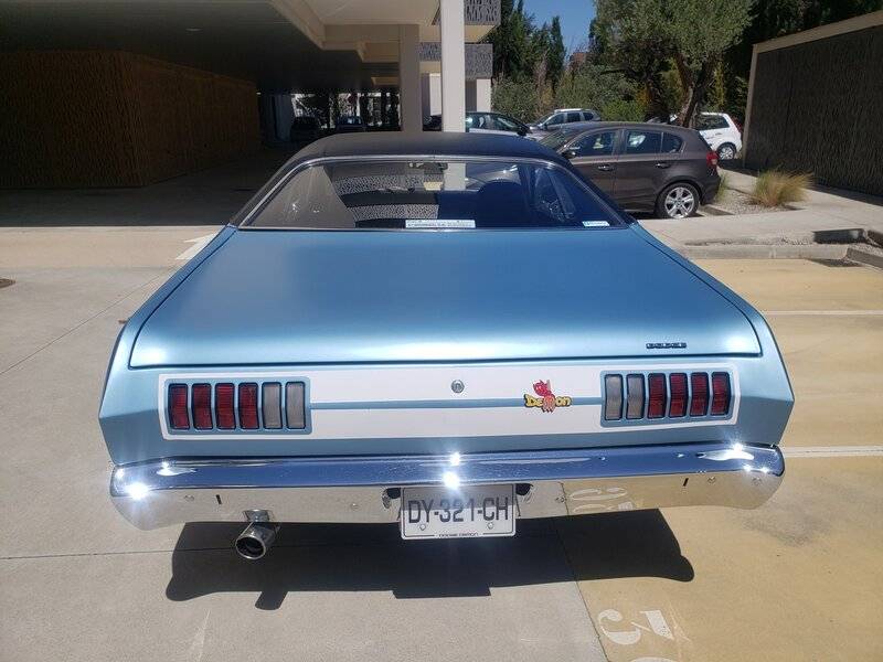

I suspect my trunk lid. I have the early flat model, the one without a rib in the middle.
The lid is in an excellent shape, but is it possible that the inner liner hits the outer steel sheet causing this noise..?
I will try driving with the lid removed, but wanted to know what you think about that?
Cheers... :)
François

Also, check inside the trunk along the sides where the dropoffs leave a gap between them and the quarter panel- errant tools and other objects have a nasty habit of falling in there and driving you crazy as they bounce around...

If it is actually the trunk lid inner liner hitting the outer steel sheet causing this noises you suspect, you would likely be able to feel/hear the movement of it by you simply pressing down on the lid after being closed. If there is excess movement causing noise, likely causes are bad seal, or incorrectly installed springs, hinges, latch issues, or trunk misalignment. Nonetheless you could begin checking by simply temporarily placing a few clean soft wash towels between the lid and trunk opening perimeter. This should generally rule out trunk lid movement caused noises and you would avoid all the work of actually removing the lid like you mention doing.
Also, this is not an idea for many/nowadays, but here is something we would do in the old days to quickly/easily figuring this out would be to find a volunteer to jump in the trunk while taking her out for a quick spin. They could listen to identify the cause in person. In modern times you can put a GoPro camera in the trunk, and or alternatively remove rear seat back with liner, and bring someone along to do some observing from cabin passenger seat while you drive. Good luck.
If the noise sounds tinny, I would suspect that the sealer between the exterior sheet metal and the underside support bracing has separated. If the sealant has turned loose, try this experiment, fold a couple of pieces of cardboard and put it between the bracing and the sheet metal. If the noise goes away, there is the problem.

The sound isn't tiny. It's loud....
And it's impossible to put a cardboard piece between the bracing and the sheet metal : no opening except the ones for the wing.

It could be something under the car, like exhaust etc. or something that fell down in the trunk extensions of the quarter panels...
Remember what I said the spare tire holds the gas tank tight. The straps holding the tank are mounted to the brace on the bottom of the spare tire well. The long bolt for the spare tire pulls up on that brace using the spare as the support. That is why driving with a full tank of fuel without a spare fastened could cause the tank to drop. And if the well floor is rusted the tank falls out. Also check your top shock mounts in the trunk . Or it could be the tail pipe hitting the tank or the frame,
I tried to push and pull the gas tank up and down, but it doesn't move at all.
The exhaust pipe and muffler don't touch anywhere and the shock absorbers are brand new.
My trunk floor is healthy
I really don't know where this noise comes from.

New Shocks? I've had new parts be defective or fail. I would look at them again if you can't locate the noise
Cause to the noise, I thought of faulty shocks and I replaced them some weeks ago (during springtime). But with both the old or the new shock absorbers, the noise was and is still there.
Here's what happens when I push with my thumb on the trunk lid.
The smooth outer metal sheet is elastic. It's noisy and also hits the inner bracing (the space between them is thin, maybe 2 or 3mm)
The median rib on mid '71 trunk lids is probably how Chrysler fixed the problem.
Now, how correcting this problem?
I though about using expansive foam but there's no way to access the noisy area.
Another solution : drilling a little hole into the sticker and the inner sheet. Sticking a nut and with a screw, slightly pushing onto the outer sheet to immobilize it and by the way turn it silent.
I don't know if I'm very clear but I do not see any other solution.
