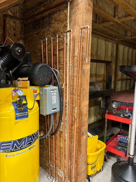

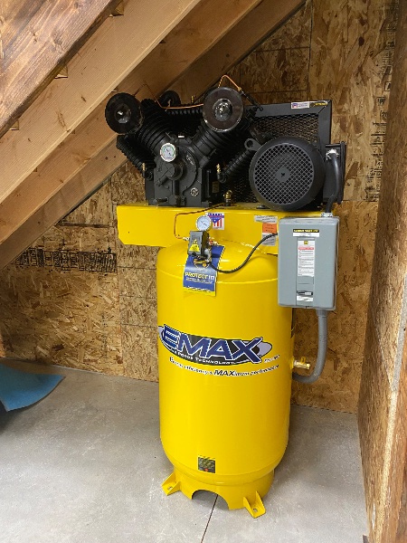

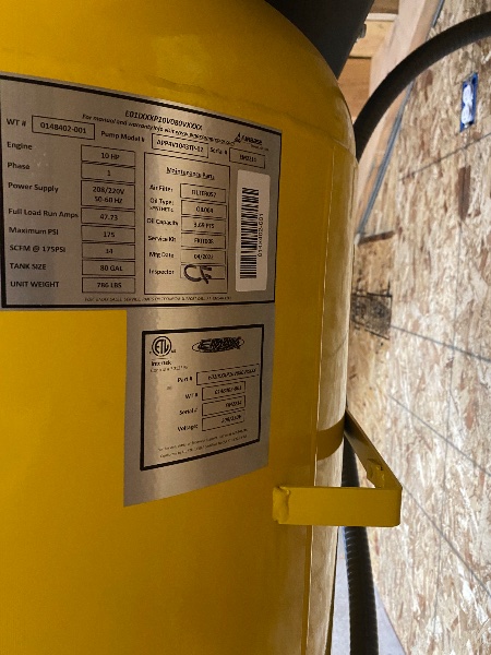

Buy once cry once I bought an emax 10hp, bigger issue you will have is if u get a blasting cabinet u need something that will keep up with it. View attachment 1716494511View attachment 1716494510

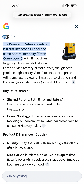

That’s the Emax air compressor which is Owned by Eaton Compressor… so the compressor you posted is from the sister company of the one I posted above and they are made in the same factory in Ohio. Learning this all as I research today.
This Northstar compressor at Northern Tool is also produced by Eaton Compressors which is why it looks exactly like the Eaton Polar Air one and has the same exact specs as the Eaton Polar Air compressor.

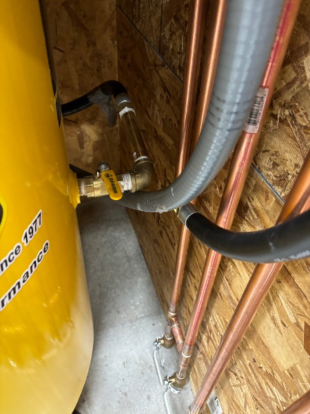

Yes I just didn’t want to keep upgrading as I got more into the cars. U have a good size shop long distance on hoses blasting cabinet in future, painting using a DA, plasma cutter. My thought was just do it once. I also built a radiator for water separation.
Yes I just didn’t want to keep upgrading as I got more into the cars. U have a good size shop long distance on hoses blasting cabinet in future, painting using a DA, plasma cutter. My thought was just do it once. I also built a radiator for water separation. View attachment 1716494558View attachment 1716494557
That’s a clean set up! I just know a 4-6k air compressor is not in my cards at the moment unfortunately. Maybe I’ll take the time and just get one after the shop remodel and car is painted.

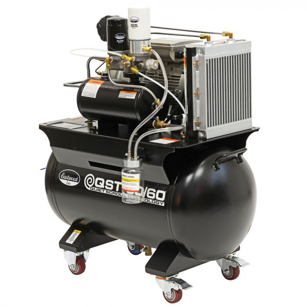

I have this Northstar compressor. It keeps up with my Eastwood blast cabinet and also a needle scaler I used for hours at a time. I haven't tried a DA sander yet but that adventure is on the horizon. A nice side benefit, it is relatively quiet.
