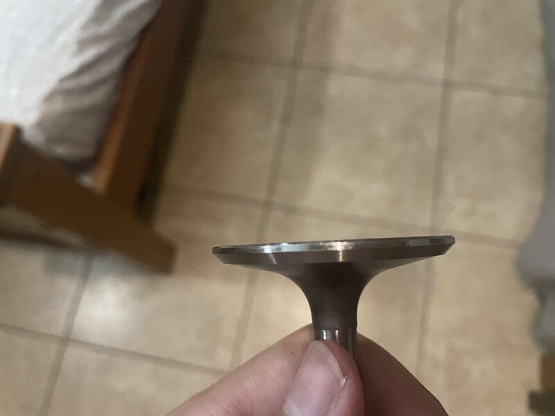

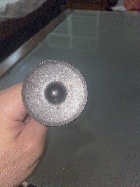

Hello everyone. I have a Melling v0548 valve and an SBI 00548. I have noticed there are some differences between them.
The SBI valve has a step on the underside of the valve head, and its finish is different than the Melling. (SBI on the left, Melling on the right in the first and second pics)
SBI:
Melling:
I also noticed the Melling has a fatter margin and a wider seat surface than the SBI. My question is, would it be worth it running one over the other? Or I could go either way without much difference? The main thing that’s throwing me off is that step on the SBI which seems to me to be the biggest difference. I’m thinking it’ll be a sharp edge in my combustion chamber. Don’t know if I’d like that.

It will darn sure hurt flow !!!
I'm FAR from a flow expert, but I fail to see how the step on the chamber side of that intake valve could in any way impede flow. Since the intake flow is coming from the other side, that step has no bearing on flow, IMO. So I'm not sure I would include the step in my decision process. Maybe @MOPAROFFICIAL will chime in. He's forgotten more about cylinder head flow than a lot of people will ever know.
They all have to meet a certain spec so however they do it is on them apparently one has a little deep dimple while the other has a lesser deep dimple but kind of a cutout on the other side. Between these two no it's not going to matter at all.. this is kind of like .."which turd is the shiniest".
You would be surprised at what can actually impede flow , I`ve helped my head man and long time personal friend (18 time national record holder) on 3 diff. sets of heads , (mine) , all flowed after and before , a little thing the size of a hangnail can affect flow a bunch !!
The valve head angle,shape, thickness all majorly impact flow.
The tulip vs the nail head ...
It's not the stem 3/8 vs 11/32 vs 5/16 -8mm... so much.. it's the door thing called the satellite, under head..
Is it 12 degrees? or is it .500 thick and 45-60 degrees like a tulip.
The magic trick of the Charlie 302 vizard show , for instance , was a nail head valve in place of a tulip...its worth over 12 cfm.
