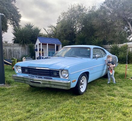

It was a gamble at 12k (Australian), as paint was all cracked and looked like painted with a brush, interior was killed by UV as California car but looked to be rust free..... time would tell. The rear quarters had some questionable repairs that had me worried. I ran a magnet over the car and didn't look to be full of bog.
She was no beauty queen thats for sure. 74 model with a 318 in a light blue with blue interior.

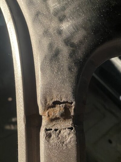

Lucky and unlucky at the same time, from B pillars forward near flawless, rust pin hole in drivers door, rust where A pillar meets the roof and little rust in top of boot under rear window in the drip rail.

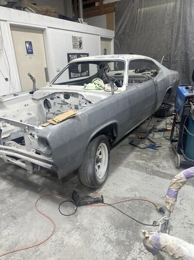

Door and guard on the passenger side were near perfect other than shopping trolly dents to be nocked out and smoothed over. Now to try and find a quarter panel not going to be easy given my location. Fast forward to April 2023 and finally started work on the body. Strangely enough found a guy in Australia selling the exact patch repair i needed for the passenger side.
Also found a panel beater who only does old cars, at a good price and happy for me to bring the car in and out as i please. We deleted the antenna hole and have deleted the rear side lights. Finding a drivers quarter for the drivers side was the next task.

Original panel was removed and time to see what lay behind.
Some one had tried to pull the quarter damage and damaged the space frame, as looks like put a bolt or something through it trying to pull the panel. The space frame was repaired with a new welded in section to patch hole and all behind the quarter acid washed after getting into bare metal
The only proper rust was just behind the wheel near the drain hole so cut out and repaired. Then all primed ready for new panel

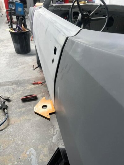

Drivers quarter panel all fitted up, we cut the roof section off so could tidy the lip up as the quarter slides up and under.

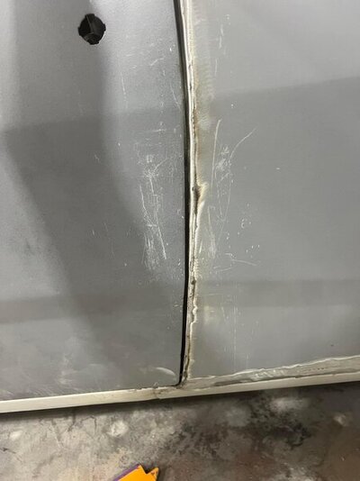

One thing i notice is many people online cant get the bottom of quarter to sit factory it has a triangulated gap to the underside. The reason is, is the amd panel is 20mm too long underneath, so we cut it and shortened with to get a perfect fit.
The sill was perfect and required no work, front guard just needed a little tap here and there. The rear sale plane required a lot of tapping and rubbing but has come up perfect and we have got the light chrome surrounds to sit perfect and confident with the gasket will seal water tight

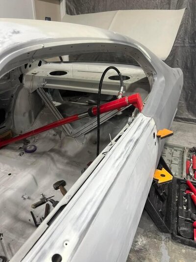

So we found that from slamming the doors the B pillars had rolled in. Very common on old coupes, the dead give away was guard to door was perfect and only half the door gap correct from door to quarter as the B pillar rolling in. Pretty much impossible to have bottom half of door correct and top half wrong
So porta power and fixed!! Its things like this many people miss and wonder why they could never get their gaps correct and everything to line up when done.

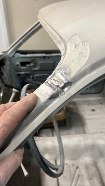

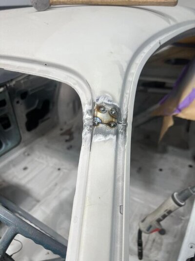

The original A pillar to roof seams have been patched and seam welded rather than lead whipped or bog to avoid cracks with power being put through the A body, same was done with the roof to quarter seams. One side had some signs of rust
Cut out and patched hopefully stronger than original and less chance of getting the common hair line crack
