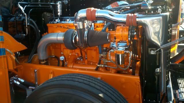

Everyone's tired of the same old engine.
1000 hp old mech. Cat
